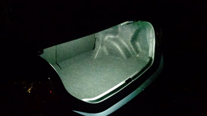

There is a small tab on the front part of the"cage" that allows it to drop down. Even replacing the bulb with a multi-led bulb is nowhere near enough for the trunk. I ended up adding 2 3LED strips(good quality) and now the trunk is BRIGHT. 10 minute job
That's nice where did you run your wires too if you don't mind me asking
I cheated a bit, just ran them on the surface, I'll try to get a pic later. What I did was take the stock bulb, cut the "globe" part of the bulb off, soldered the led leads to the filament tabs on the bulb, and just popped it in place. The LEDs are surface mount with 3M tape and the wires are only about 6" long, you can't see anything unless you're inside the trunk, the "cage" for the bulbs snaps in place fine. I am REALLY trying not to touch the factory wiring, but you do have access to the bulb wires right there at the light.
