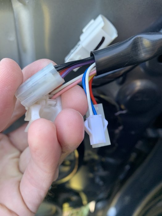

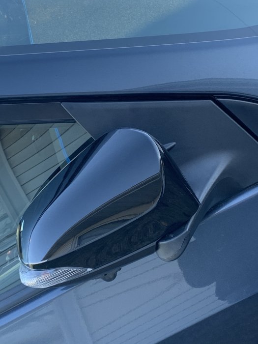

Hey Betzy,

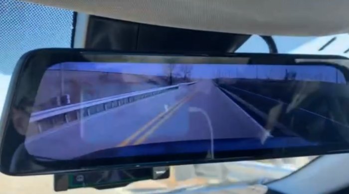

I finished days ago but was too busy and didn't get a chance to upload. The hardest part of this is routing the wiring to the turn signals through the factory door wire harness (since you want it to look as close to OEM specs. as possible). I found a Toyota install sheet online for an older model (not Corolla), but they routed the wire from the mirrors to the turn signals in front, so I did the same. I included some pictures so you know how they fit in if your Corolla never had the turn signals, to begin with (if yours has them already, then it's more plug-n-play friendly than my install). There are two cameras on the side mirrors which help with blind spots, and I also routed that to connect to my factory Entune Premium and aftermarket rearview digital mirror (this digital mirror is on par with the Rav4 digital mirror).
Also to address the OP's concern, I would check with your auto-folding mirrors locking+ and unlocking+ wires, seems maybe you have a short and or loose connection. If you check these connections with a multimeter and everything is fine, I would check your factory mirror module or a setting could be changed also (for example: these aftermarket ones have a setting where you may disable and then re-enable the automatic folding feature by turning ignition from OFF to ON, then pressing the locking switch on the door panel 4 times in 5 seconds, if the mirrors fold, it means you have turned the "Auto" mode off. Repeating the same enables them to auto-fold once again).
