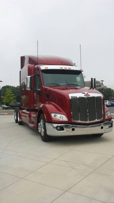

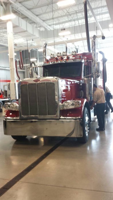

uploadfromtaptalk1408923317803.jpg uploadfromtaptalk1408923328802.jpg I went through diesel mechanic school in California and lets just say that I excelled. I was chosen along with 10 other students across the nation to go to Chicago to do advanced training paid for by Peterbilt. When I finish my 3 months in Chicago I'll be going to a dealership as a factory trained tech.
Those are 2 of our trucks that we get to work on.

Nice! Not a lot of talented diesel mechanics out there so there is money to be made.
For sure. Im soaking up everything I can in this class. I am surrounded by some of the most successful people I've ever met and Peterbilt has provided us with more resources than a lot of dealership mechanics get. This is a once in a lifetime opportunity to become an excellent diesel technician and I plan on using it for everything it's worth. When people ask me what I'm learning, I tell them "Anything and everything they will teach me."
