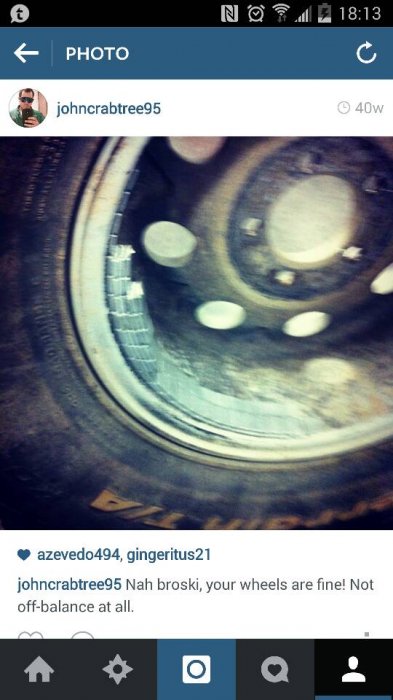

AHAHAHAHAHAHAHA!!! I saw something similar to that. Guy kept saying that no shop in town could balance his tires. I threw it on the balancer and saw a hump in the tire ... where the tread was getting ready to separate.
Most people throw it on the balancer and go to something else because they are under a time pressure, so they miss things like that. Me, I NEVER walked away from the balancer, period. I don't care how busy it is.
