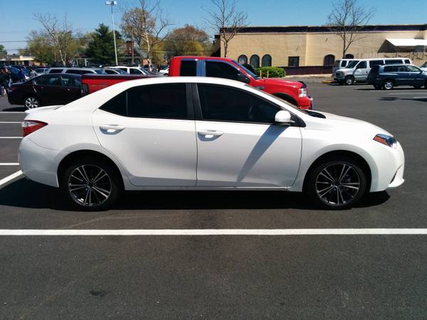

Well the first thing you should know is how big they are, 16- 19 inch wheels should fit but honestly all you have to do is try one of the wheels on and see for yourself. and if they do fit upload a picture here because id like to see how it looks =D Good luck!
I believe those are!! Nice man! Did it fit well, or did u have to use something to make it fit? Because to me the center bore looks bigger than the corolla rims.looks good man
That is not my car. I believe someone posted that pic on here awhile back so I just Googled it. The center bore on the Brz is 56.1mm where ours is 54.1mm. That's the only difference. It would be like running aftermarket wheels without the Hubcentric rings.
