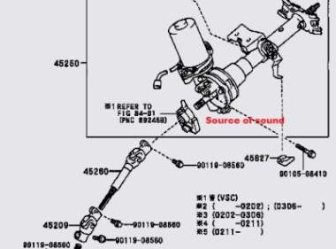

Af first one service suggested that problem is the appearance of backlash in steering gear, but no backlash could be detected at the technical examination. It's like the sound is coming not from the floor but immediately below the steering wheel approx 2-3 inch below.
My mechanic suggested me that only if I insist he could try to open this part that is shown like one module in toyota parts (very expensive). He's willing to disassemble this part and examine what could be the source of this sound. He's against the idea that problem is in steering gear. He told me that safety is not an issue and that I could be safe and should react only when there is a backlash noticeable that could be measured.
So right now, this sound is only irritable.
Official toyota service suggest to replace the complete module (45250) but that is almost half of the value of the car.

Looks like you do have electric power steering. Best way to tell would be to be to pop open the hood. If you have a place to put power steering fluid, hydraulic. If not, electric.
Do this, turn the car on (don't start it), and move the steering wheel left to right, see if that knock is there when the electric power steering system isn't on.
If you hear the noise with the electric power steering off, bad u-joint (pretty damn rare since they are under little force) or the coupling to the electric motor has slop in it.
If you don't hear it ... then chances are there is an issue with the motor.

great advice!: I have made the test. On a very small downhill I turned key to "ON" position and then I moved steering wheel from full left to full right and vice verse (it was very hard) and there were no click sounds. When I started the engine it was of course much easier to move the wheel but there was a click sound after turning couple of time lef-right.
Normally this clicking sound is not always present but very often.
So to be sure, I'll ask mechanic to put car on the crane and perform the same test just to see if this will happen. In that case there will be no resistance from the tires and weight of the car.
So far it is very likely that electric motor has some issue or there is a backlash in the el. motors gears in the steering column.

My mechanic managed to solve the problem. First I have checked to see if this is maybe an old problem but recall check confirmed that this particular vehicle was not in a group that had problems with the steering.
The mechanic I went to, dismantle the steering column and the electric motor and found one loose nut (inside the steering column where el. motor couples with the column). When this was tighten, no clicking sound was present anymore. So the problem is solved very cheap for me and without using any spare parts :)
