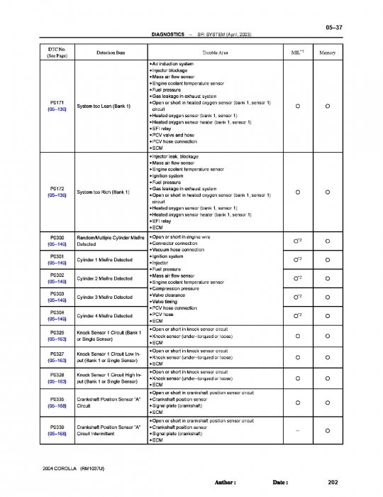

Do you have a diagram of the knock sensor circuit?
Do you have a diagnostics manual?
P0328 - "A P0328 code is a generic DTC, thus it applies to all makes of vehicles, and refers to a high output voltage of the knock sensor. In many cases, this means the voltage is above 4.5V but that specific value depends on the specific make and model of vehicle."
I need to know what connections to check and what values are acceptable to verify the integrity of the circuit. Otherwise I can throw parts at it all day like Toyota wants to do.
