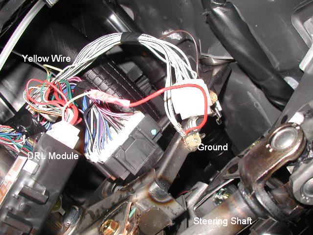

Under steering wheel yellow wire (see picture). Did not work

Here is the infor on the yellow wire:
I couldn't take the headlights turning off and on during bright sunlight so I decided to disable the automatic headlights and the DRL's. In order to do this I simply snipped the yellow wire going to the DRL module above the gas and brake pedal, then grounded the side that goes to the module and covered the other side. There was a convenient ground right by the module that I used. I tested it out and couldn't find any ill side effects. No DRL's and I don't have to mess with any brake wiring. The yellow wire is a signal that the car is running. If the yellow wire is grounded the module doesn't think the car is running and if it's not grounded it thinks it's running.
Here is a picture:
