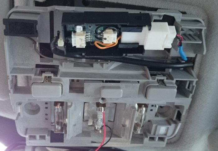

I received a message from someone that the "Relay integration unit" might be broken because it doesn't like to have extra lights connected to it. I wonder what that will cost and where to find it in my car.
I just opened up the light unit and found a black rectangular box in it and wanted to know if someone knows if this could be this Relay integration unit!
I will try to attach a picture of it.
