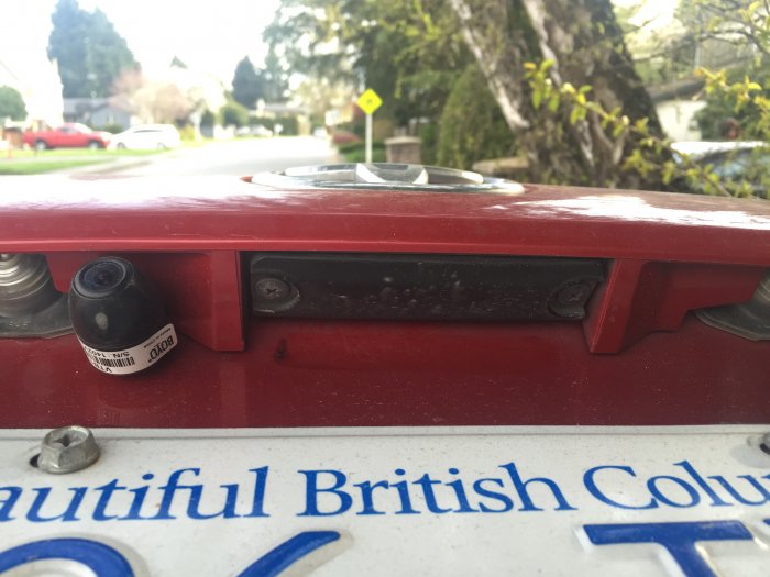

This is the photo of my trunk release button which is above my license plate.
It uses the proximity key to open, usually you held it for a second or two & it popped open. But one day it just stopped. It has nothing to do with the key because I just changed the battery recently.
Just wondering if this is a common problem with people and if the wiring is usually the culprit or if I need to replace the button mechanism.

I'm not familiar with that switch...
but looking at this ebay listing shows a pressure sensitive switch.
It's possible the switch itself is faulty... or maybe the wiring has come loose ?
You'll likely need disassemble that to inspect it further.

I have the same one. We have keyless entry that is why we have it. What I would do is remove the trunk liner and check to make sure the plug is connected. if it just "broke" than there is likely an electrical disconnect somewhere. if it is not as simple as the plug being loose then next thing I would do is get a new pad and install it. either a new one or one off a car at a wrecker. you can get a diagnostic done but that would probably cost a bit much. By the way is that camera stock? if not where did you get it? I am interested in a backup camera but want a simple install without mayor modification.
