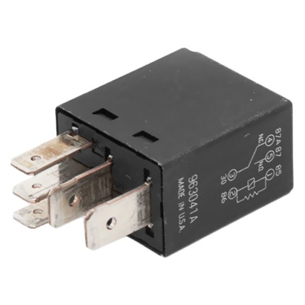

  2. Where is the starter relay located? (not the starter solenoid)
I want to swap out the relay and have looked in the relay/fuse box under the hood & it's not on top of the relay box near the drivers knee.
