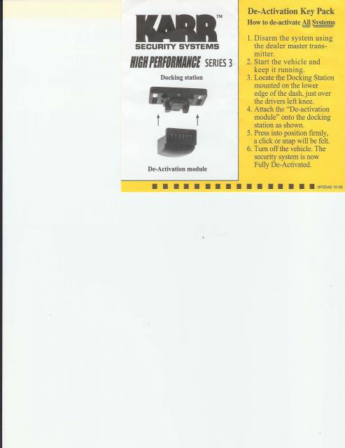

While I'm not a Corolla owner, I think this info may still help. KARR is an aftermarket alarm company. If it was shown on your window sticker, it must have been on one of those supplemental window stickers (which may look official). The KARR system didn't come from the factory. If your car has keyless entry remotes, you can probably find an upgrade, or find the same chip for less, elsewhere.

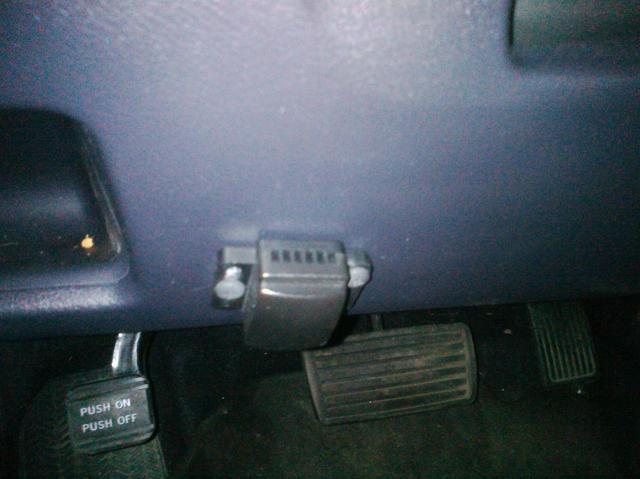

OK, here is an update, we need to get LED chip (Blue, Green or Red color depend on your alarm model) for activate. Yesterday, I went back to dealer, and got activated for $250 (not $850 from the finance guy).

On second look, it looks like they cut the LED/chip out of the car. Just left the ribbon cable it was attached to dangling.
