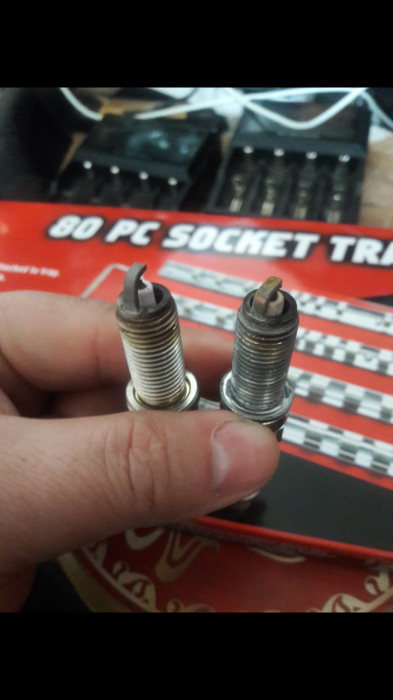

left oem. Right Pulstar.

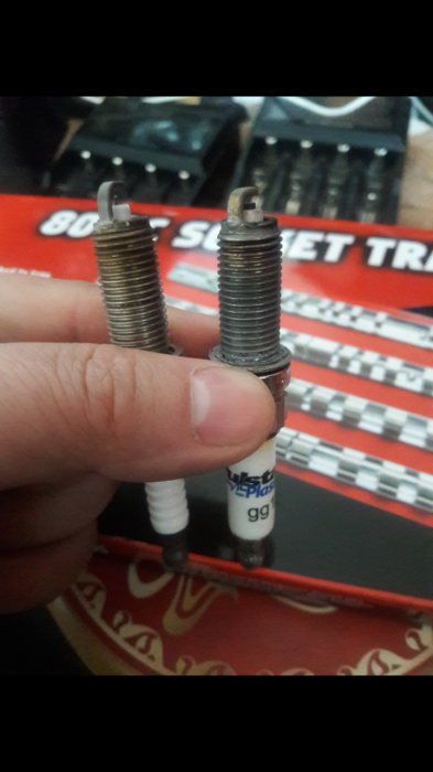

Pulstar alone.
Sorry i didn't take pics of all three plugs. I was in a hurry before temperature outside reached freezing.

Pulstar alone.
