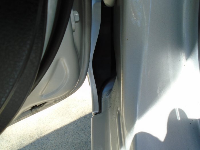

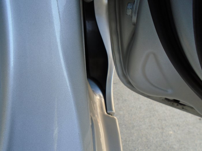

I noticed that on my car ( 2017 Toyota Corolla LE) the gap where the side panel attaches to the floorboard area is too large on the drivers side. The passenger side seems like a good fit. See attached pictures. The view is from standing behind the open front doors, looking downward, on either side as if you were entering the car to sit down on the front seats. You can push the drivers side panel to touch the floorboard area, but it just flexes back to its original position (it's loose). Could be an area where my strange noise is coming from. What do you think? Driver Side Front Door View - larger gap.JPG Passenger Side Front Door View - correct fit, normal gap.JPG

I am going to take my car back to Toyota Sunnyvale, CA (where I purchased it as a Certified Pre-Owned Used Car less than two - 2 - months ago) service department and leave it with them to check out and fix / repair and I will ask them to check the "door check arm" and the filler piece behind the hinge area.
The Toyota Dealer Service Department determined my current clicking / cracking noise to be a "spot weld" issue and decided to buy back my car from me at my full purchase price.
