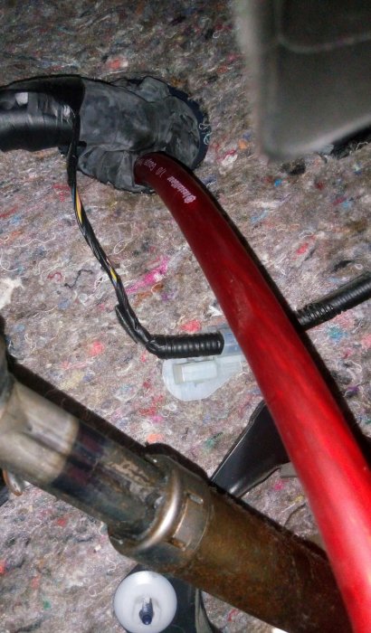

so i see 2 spots where they have a nice big grommet with a pretty fat set of wires going through. One next to the brake booster and one under the glove box. How the hell do u get that grommet out cuz theres no way to squeeze a fat wire through there. The grommet on the engine side has 2 big rubber posts, do those unlock the grommet some how? Do u guys have any pics or anything. I would hate to cut into it if i dont have to. Maybe i can get a pic on here, brb.
*EDIT*
Just pulled on it with a set of channel locks from the inside of the cab and it popped right out. Looks like im gonna have to cut a little out anyway to get the wire through.
