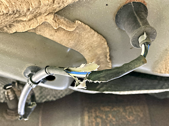

Here's something... I just put the car on ramps and took a look at the wire from the downstream O2 sensor. The wires themselves look intact but the insulation has some damage. I'm afraid to try disconnecting it as I usually wind up making things worse, but I'll ask: do any of these connections come apart easily? Thanks again!

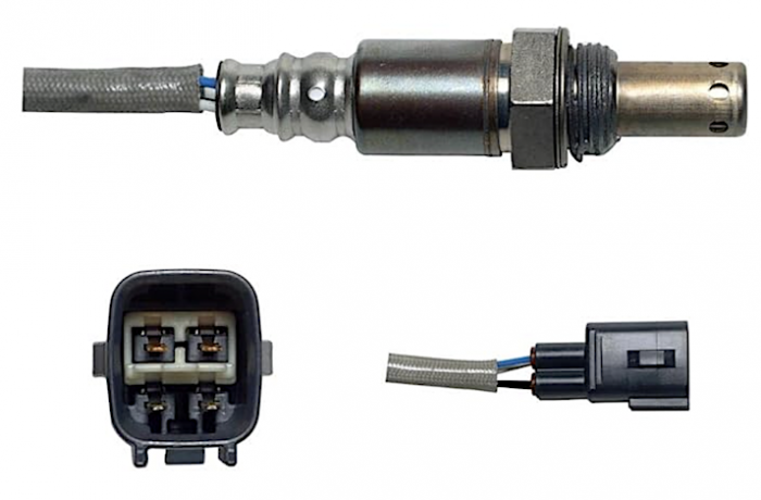

More researching... this is the correct o2 sensor (Denso 234-4305). I see it has a clip-on connector. Is that inside the rubber "boot" in the foreground of my picture above? I don't believe I saw it when I was under the car (though I didn't get a great look at the o2 sensor itself). Thanks once again for any helpful tips!
Sorry for cluttering up the thread. After watching a few more u-tubes I see this clip-on connector is inside the passenger compartment, after the rubber boot. And, the boot is included with a new sensor. So, hopefully my last question here :) For a very occasional weekend mechanic guy, how hard a job is this? I'm pretty sure I have the special split socket for the sensor, but just a basic ratchet set and breaker bar. I can see trouble ahead trying to get the old sensor out! Anybody with experience want to share? Of course this might not fix my original issue, but if the sensor is bad and I have a shot at clearing the CEL, it needs to be done! Thanks.
