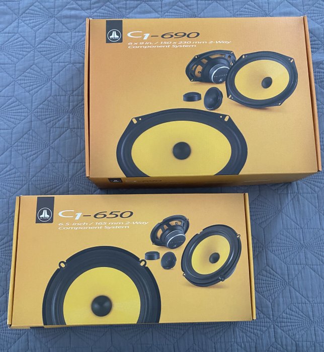

I’ve come to realize there are no wiring diagrams or color codes on the internet for the speaker wire colors for the newer generation corolla. So heres a little help for anyone wondering , i didnt buy clips i cut that shit off im cheap what ever. In the rear its the standard colors you find online. But the front is a joke , they ran pink wires with a blue stripe (-) and green stripe (+) on the other. The leads from head unit go straight to the tweeter connectors then those act as jumpers to two other colors to the speakers ,pass side pink with a white stripe (+) and pink with purple(-). Driver side pink with white (+) stripe, and pink with blue (-) . I went with JL audio speakers and man do they sound good. A lot of bass. Mind you I did dyna mat my car , helps big time with road noise. ... i hope this helps
