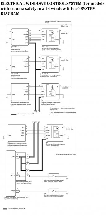

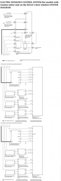

    Oem auto window on all 4 doors require different switches to all 4 doors. The connectors and wiring is different since all the window signals will now go through the LIN network compared to the driver window only.
    Attached are the general schematics of the two systems that I got from a russian site. You can see there are lots of differences. IMG_20180318_162721.jpg IMG_20180318_162754.jpg
