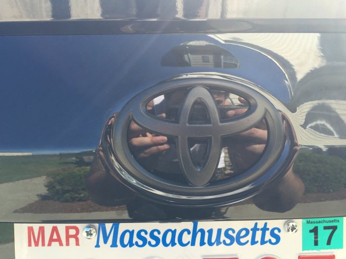

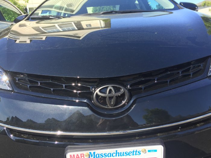

Plastidip them. I just bought my corolla last week and did it. Real easy, and only costs $7, buy it at home depot. Research plastidip, its awesome. Just clean the badge, mask off the area for overspray, i sprayed 5 coats, 15 mins between, waited 45 mins and removed the mask and excess paint around the badge. Plastidip is fully removable, research it and youll understand better.
3rd vote for plastidip. If you don't like the dull finish that plastidip has, you can also use the plastidip glossifier and it will give it a nice shiny finish like mine. :)
