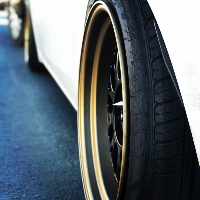

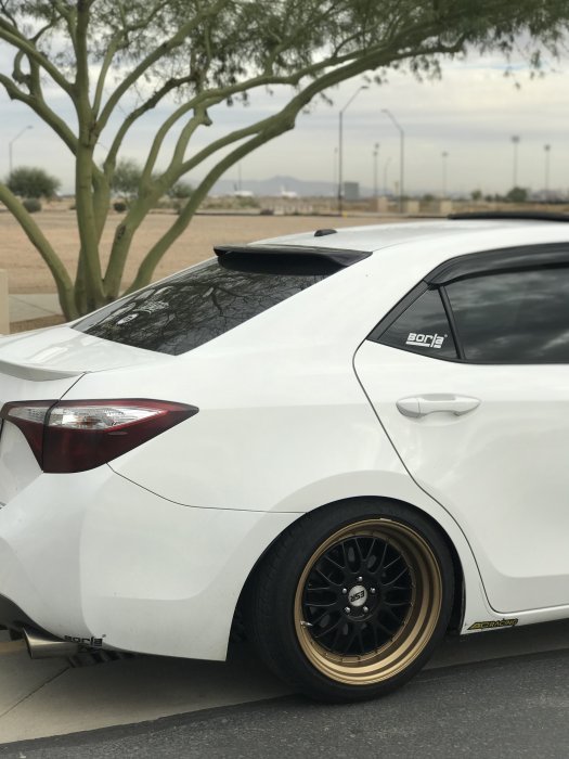

I am running a 215/45/17 17x9.5 5x100

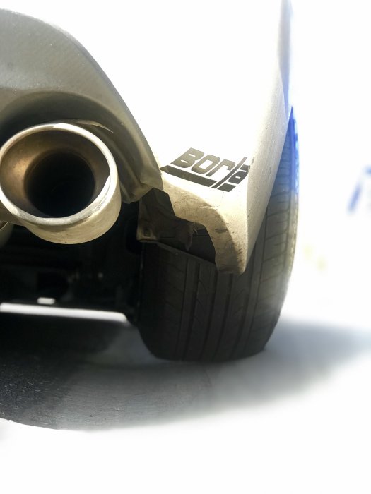

Just make sure to roll your fenders!!
