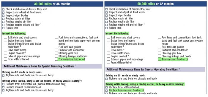

I do not see any mention of tranny service in the maintenance guide
Yes : it mentions to check every 30K and change at 60K (for severe usage). It's the same indication for any auto/CVT trans from Toyota. 30K sound a bit overkill - more like for a manual transmission - but like early oil change, if it brings nothing, it also can't hurt !

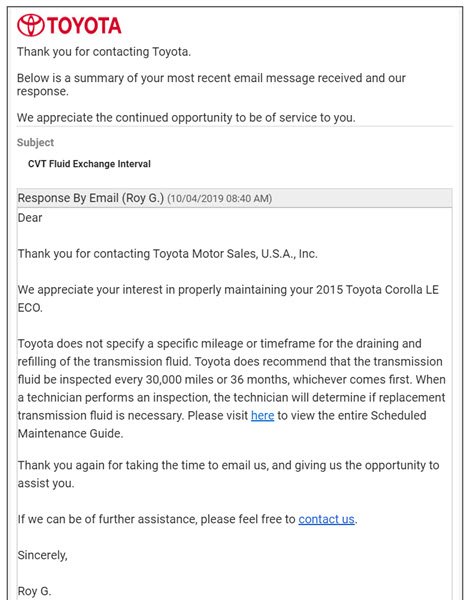

Actually, I sent an email request to Toyota customer service regarding the CVT fluid change interval since the dealers in my area are providing conflicting information. Some say 60K, most specify 100K earliest. My owners manual has no reference to CVT service at all.

Another town crier
The owner manual doesn't, but the maintenance guide that comes with the car (at least came with mine) also says to inspect fluid every 30K (and decide, I assume, except for severe service which recommend a change at 60K). It's the same whether AT or CVT.
I'll have to take a look at my guide. Inspect transmission fluid on a CVT. I wonder what that means. No dipstick. Probably just check the level with some type of an acoustic sensor. Well... screw it. Not paying for that, if no leaks. I'm going to wait until 100K for replacement.
As far as I know, it's about retrieving codes, especially about temperature peaks, a critical data to insure the fluid wasn't compromise at some point. And visual inspection for leaks. Not a big deal all in all.
