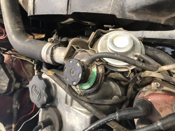

My 82 corolla is my pride and joy, as well as my daily driver. Recently, the EGR vacuum (or so I was told by firestone) has stopped working and needs to be replaced, but I cannot find the part for the life of me anywhere!! If anyone has one, or can find a link to one that I can buy, please let me know!!

Oh.. The part you show isn't the egr valve. The silver thing in the pic might be but the black one looks like the high altitude module on my car... The egr should be on the back or side of the intake manifold...
