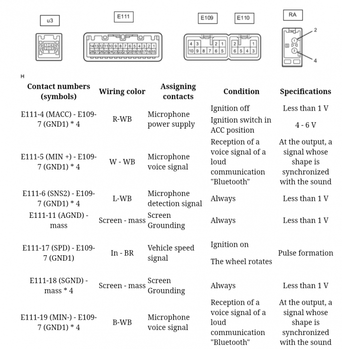

Anyone know where the factory mic is in the 2014 corolla? Non entune version (L model)
In changing the headunit out and want to put the new Mic in the same general area. Where did everyone else hide the mic to their aftermarket headunit?

Yea I don' get that. Only thing I could think is polarity issues. I need to see what color the wires are for the mic. I might have to play with it

The factory mic is integrated behind the map light panel.
Wiring to the non-entune radio is IMG_20180403_184835.png as attached. There are 5 wires for the mic. Pins 4, 5, 6, 18 and 19 of the 28 pin connector (E111).
Thanks! Will definitely reference this when my wiring harness comes in. In the mean time I'll keep googling to see if someone did it successfully.
