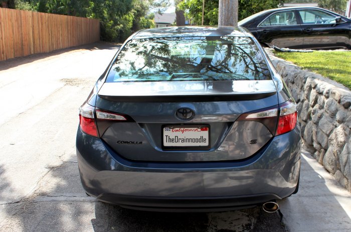

Nah man I have plasti dip on there right now. I'm actually looking to go with full on black paint and clearcoat. That's why I need to remove it rather than just spraying it on the car. I just dipped it on the car. I want that shine haha. and before someone says it, no plasti dip glossifier is nowhere near as shiny as clearcoat. LOL
Here's my setup if you haven't seen already.
