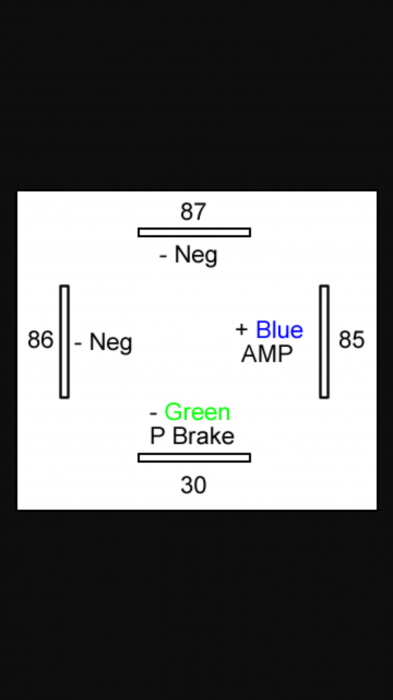

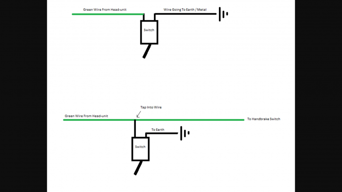

Well the camera is very easy to install until u have to find a signal wire to activate the reverse cam. You can get that signal from one of the reverse bulbs (+ or - cable ). I used the positive cable. For the video play while you drive u need to install a relay n a switch to simulate the hand brake.
