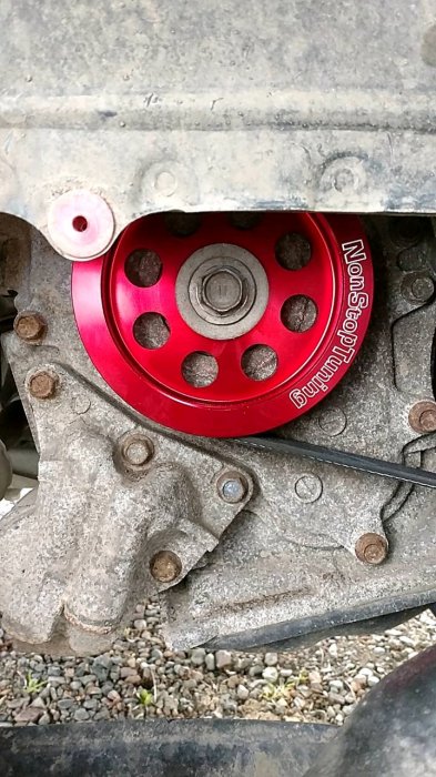

pulley on. absolutely no noticeable difference in response or hp.
Theoretically, the engine should be faster to rev. That is what the others say who have installed a lighter pulley. Horsepower wise, you won't be getting a huge gain but maybe a horsepower or two which may or may not be noticeable right away.

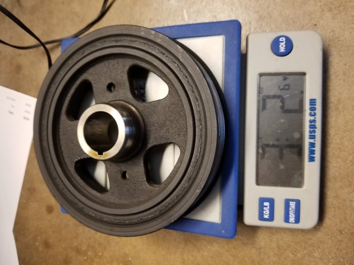

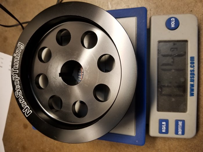

I know it DOES free up some. Just saying its not enough for me to notice at all. I did back to back runs on my 2014 s plus with 6 speed manual within an hour and was really trying to pay attention to the car when i did. But theres honestly not much weight difference between the pulleys. the factory one is fairly small and light compared to older engines. For the nearly $300 it took to get to me in canada I cant recommend it.
On a side note there was no increase in vibration or other side effects after installing the pulley
