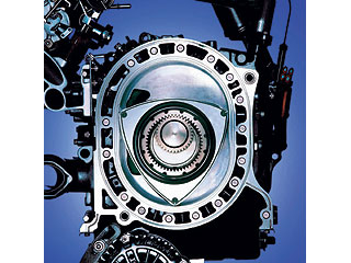

#15
This is a rotary. The rotor spins around the casing of the engine on an eccentric gear. One edge is doing intake, the other edge is doing compression/power, the other edge is doing exhaust. The rotary is sealed via apex seals, as opposed to piston rings.
That is why rotaries lack torque, but can spin at a really high rpm and make horsepower.
With a piston, the explosion of the fuel occurs and forces the piston directly down, which is what gives them their bottom end power. When a rotary goes through ignition, the explosion occurs but pushes the rotor along at an angle instead of directly.
The advantage is that you get 3 explosions per revolution (albeit smaller one), while an Otto 4-stroke engine gets 1 every other revolution, with a 2-stroke getting 1 every revolution.

Efficiency in terms of power output per unit fuel is what I'm talking about. There are many different types of efficiency.
A rotary engine is a 4 stroke engine. It has an intake stroke, a compression stroke, a ignition/power stroke, and an exhaust stroke... go ahead and count them. A 4 stroke engine has nothing to do with pistons. There are also two stroke rotary engines, they just were not used in rx7's. Please don't try to explain an engine to me that I've rebuilt and driven for 3 years.
Rotary engines don't so much "lack" torque as they just rev so high that they make much more HP than ft lbs. We are accustomed to engines making about the same amount of HP as ft lbs. That said, my rotary engine, when it was stock, makes peak torque at 3800 rpm. The 1zz-fe makes peak torque at like 4200 or something like that.
Rotary engines DO NOT have 3 explosions per crankshaft revolution (which is what RPM measures). Yes there are 3 explosions per rotor revolution around the eccentric shaft, but it's irrelevant when comparing it to a piston engine. Rotary engines have 1 explosion per rotor per crankshaft revolution. That means, for every production rotary engine produced by mazda except for the 3 rotor 20B in the mazda cosmo, there are 2 power strokes per revolution in your typical twin rotor engine. This happens to be the same number of power strokes in a 4 cylinder piston engine (4 cylinders, each firing every other rotation)

The stroke is in reference to what the piston is doing inside the cylinder (engine displacement on a piston engine is measured as pi x (bore/2)^2 x stroke).
You are wrong. Rotaries are called just that, rotaries. They do not have a stroke at all. The chambers rotate, hence the name of the engine.
Just because you rebuilt it doesn't mean you know the proper terminology. You can learn something from me, or you can get laughed at when you tell other people this when they know better.

I should correct my previous post first, the rotor rotates the eccentric shaft 1 time for every three eccentric shaft revolutions, not the other way around.
Yes, pi * r^2 * h is the volume of a cylinder.
As for being laughed at? Please, if I posted this conversation on any rotary engine forum you would be laughed at for days for thinking rotaries have 3 power strokes (or I guess you prefer the term cycle) per revolution.
Rotaries are widely called 4 stroke and 4 cycle among both rotor heads and piston heads. And they're widely but incorrectly called 2 stroke engines by people who notice similarities between a 2 stroke piston engine and the wankel.
Yes, not all engines make the same peak hp as peak ft lbs. But generally engines with more peak ft lbs than hp are considered to be torquey and vice versa. That was my point and you seem to support it with your example of the 5.0. If the 5.0 revved to 8k and still maintained a relatively flat torque curve, then it would still have plenty of low end torque, just much more top end power.
Cycle and stroke are used interchangeably. You may associate stroke with pistons, but that doesn't mean it actually is associated. Read the first sentence under design:

Yes, I made a mistake. Rotary has 1 combustion cycle per revolution (spaced out that the crankshaft spins faster than the rotor itself).
The problem with calling a rotary a 4-stroke engine is ambiguity between the Rotary and the Otto engine (Otto specifically refers to a piston and valve 4-stroke engine, named after the engineer first credited with the design). That's why you can refer to an Otto as a 4-stroke, a 2-stroke as a 2-stroke, and a Rotary as a Rotary. It eliminates ambiguity between the two engines.
The stages that occur during the run of a rotary engine should be called cycles, not strokes. The term is incorrect, period.
Just because other people use the term stroke, doesn't make it correct. All it means is that there are a lot of people out there that don't know what the word "stroke" actually refers to. I'm actually surprised Mazda has that err on their website.
