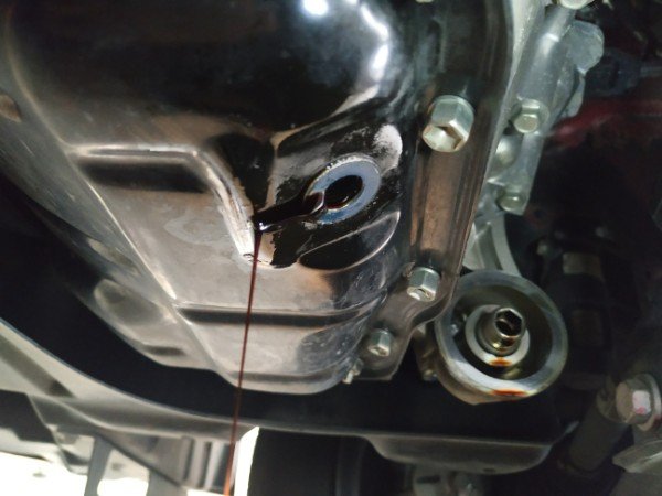

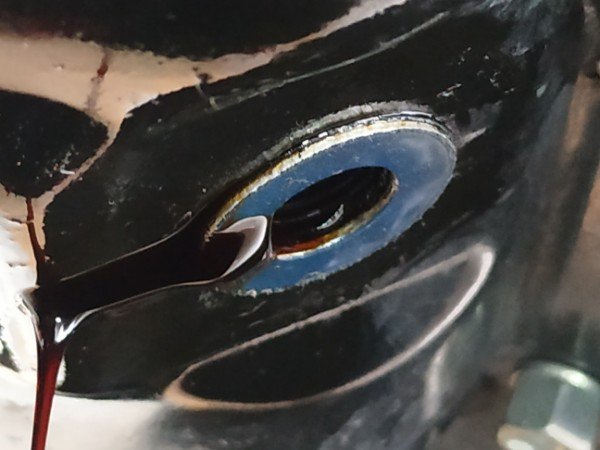

Can I borrow your eyes and thoughts on whether or not the following pics show the oil pan drain plug washer as being stuck to the drain pan?
I've started to change (2nd time) out my own engine oil and wanted to replace the washer. When removing the drain plug, I did not see a washer come off with the plug. I'm certain the washer did not fall into the oil catch pan (I checked for it). There are no leaks after replacing the plug without adding another washer. I suspect the washer is simply stuck on the drain pan.
But before I go banging it off, do you guys think this is the case? I could not remove this ring with my fingers.
Side note: If it's not leaking, maybe i shouldn't bother trying to bang or pry it off in order to replace it? What do you guys think?

1612912084231.png I have a Fumoto Valve on my car . They work great and hold up well.Only issue is they are slow to drain. Your car looks to have the drain washer sticking on there . If so they usually come off pretty easy .

Thanks for the followup ToyBoy. As others have suggested, ill carefully chisel if off, careful not the scratch the drain pan itself. I was unable to pry it off with my fingers.

honestly speaking, I have never replaced my crush washer. I have not had any issue at all with it. Oil has never leak out of the drain plug. I don't drive my car hard so I don't put a lot of stress on it. For some reason the more I read about it the more I am considering getting a new washer, but with my past experience I think why bother. I don't think that is the washer though, you should be able to peel it off with your fingers, I am do to change my oil this weekend and can compare to mine and let you know.

I will post pictures when I do mine. To be honest I would not 'chisel' anything to do with the oil pan, to me that is a recipe for disaster.
no pictures, mine pan is the same as yours and I am 100% sure this is not the washer but there to provide a smooth surface to seal on. Once again I did not use a crush washer, honestly, I meant to buy one but we got a dump of snow and I have not left the house. I am sure I will have no issues with any leaks, just I have never had an issue in the pat.

If that is truly not a washer, so we are supposed to add a washer in addition to this? I'm concerned about doubling up on washers, leading to a leak. It's not leaking now, without adding a crush washer.
I'm thinking of asking the Parts guy at the dealership when i go get more filters for my next oil change.
