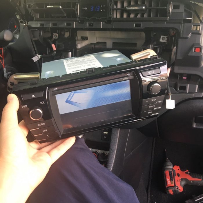

Hi all,
I was able to fix the radio rebooting on my own by buying the radio on Ebay. I have a Toyota Corolla 2014 S. The dealership wanted to charge me $1,400 to fix it, I said NO! Not to mention that they charged me $90 just to look at it, without resolving.
So i went on Youtube and found a video that teaches you how to unmount the radio, you just need some basic tools that i actually bought at Home Depot. Link here:
Tools cost: $47 (returned it 15 days later)
Radio cost: $244. I tried to attach a link for the buyer who happens to have really high ratings on ebay, but this forum says i am too new. The guy is reliable, super fast delivery. Radio works perfect. Please note the radios he sells have no GPS, but who cares, Toyota’s GPS is horrible anyways.
I hope this helps guys, i am happy as of now with how easy it was to do it myself.

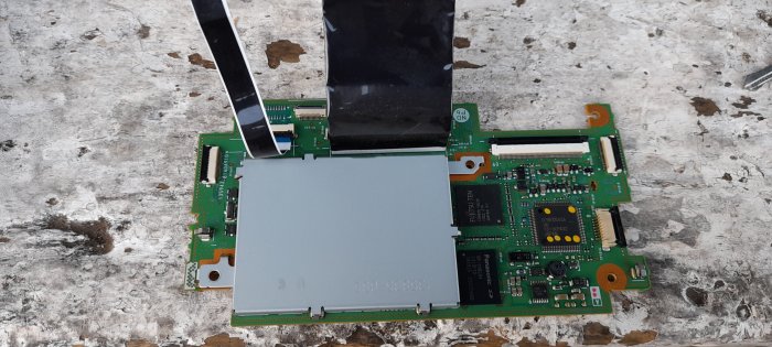

I just bought my Toyota Corolla 2014 just about a year ago and I was told to bring it in to the dealership and they would fix it. I told them I am not paying for anything. They said they would fix it. When I brought it in they slapped me with an $89 just to look at it fee. I told them they could have the car back as I've already paid them $4000 over blue book value and I'm upside down on the note. My credit is maxed. They acted like they have never seen this problem before. I told them to look its iall over the internet. Jeff Wyler of Indiana threatened to call the law on me if I didn't remove my car from their lot. I have reported this problem to Toyota headquarters, they said that they have never heard about it. If everyone complains about it we all can have our radios fixed free of charge.
#68
This problem started for me just this last weekend. I called entune customer service and support who told me I needed a firmware update. I got it to the dealer on Tuesday, after I tried several things myself. Unhooked the battery, took the dash off as suggested in the video, unhooked and re plugged in everything. Still no success. Dealer also says I need a new system and they can't update the firmware. I notice my USB doesn't work to charge my phone which might be significant, but I don't know. I have had this car less than a year. I'm also out of warranty with only 43000 on my Corolla. All I can say is I'm disgusted with the service I got from the dealer I took my car too. I know that there have been several people with the same issue. Please post if you find a solution.
#69
There's a YouTube video of a guy that found a fix for this. It v worked on my entune radio on my 2014 Corolla S!
Apparently there the guy found a Best buy tech that shared the information with him.
He says to disconnect the negative connection on your battery. Pump your brakes at least ten times. Reconnect and start your car. It works like a charm & saved me lots of money!

I didn't get into specifics but I can't understand how a hard drive just goes, talked to a computer tech friend and he even doubts there is a hard drive, he thinks it's SSD which is same kind of guts as your phone, solid state.
First off, yes an SSD can fail. The only difference between the HDD and SSD is an HDD is mechanical. If it is a 'hard drive' failing, could be a bad batch of SSD's provided by the manufacturer of the head units. I also find it odd to be '14-'15 model years with around 70k miles. Why 70k?
That said, I feel bad for those of you dealing with this. I hope there is a permanent fix besides replacing it (stock or aftermarket). I'm also hoping the '17+ have a different radio and don't have these issues popping up later too.

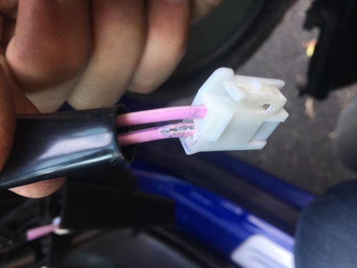

My radio just recently went black and then started to what looks like rebooting. The progress bar gets just to the end and then goes black again and starts rebooting. Any know if there is a simple fix to this? Car is a 2014 Corolla S with the navigation, 78k miles.
Looks like my front speakers are beginning to either not work, one will and not the other, I have to crank up the volume high and it seems like the bass vibration resolved it temporarily. Vibration causing wires to make contact?
I read somewhere that they had this issue where front speakers connectors were corroded. Where do they the part for this and how hard is it to fox?
I'm assuming you need to disassemble the door to get to wiring, anyone have a walkthrough for this?
That makes me think if this could be the culprit of our radios rebooting due to corroded wiring in the speakers. Makes sense but would like to know what you guys think about this since I'm just speculating. Thanks in advance!

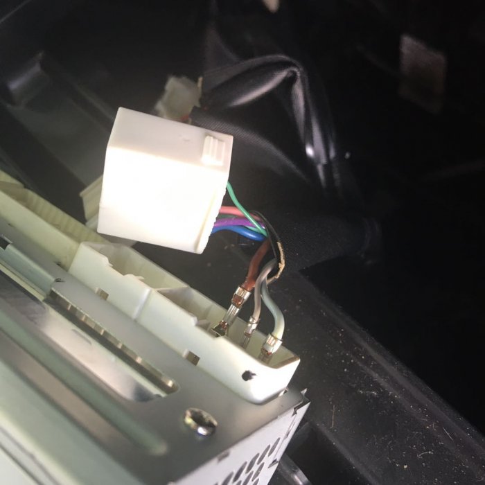

After brining our car to the dealership multiple times to no avail I finally decided to replace the radio myself. After researching online for hours I found a lot of people stating that the radio could be swapped out with the non navigation unit without any issues so I decided to give it a try.
Our existing radio was having the boot issue and the Face ID was 100150 the navigation unit. I looked online on eBay and junk yard searches and found that the cheapest I would be able to find the 100150 unit was for roughly $500-$800 at junkyards. Instead I decided to install the Face ID 100149 which is a lot more common and was able to find it at a local salvage place for $50 which was a deal since eBay even had them selling for $150-$300.
The removal of the existing radio was simple and all the connections for the most part were plug and play. The radio worked fine and all the features including the steering wheel, reverse camera and Bluetooth connection worked without any issues.
Only problem I realized is that the front door speakers are not working at all which does present you with some issues. Not sure why they don’t work and if the connections in the back of the radio differs based on the model or how the radio interprets the different signals. If anyone has any insight on this I am open ears, I tried researching wiring digrams but I’m not a install professional so didn’t really want to mess with it too much. The main issue that we have with the front speakers not working is that when you are on a Bluetooth call it seems that the default feature is for the call to come through the front speakers only and with only the small tweeters working you can barely hear the person on the phone.
If anyone can help with the front speaker issue please let me know. For everyone else who is sick of dealing with dealerships and Toyota in general and wants a cheap alternative try finding the 100149 Face ID at a local junk yard and replace it yourself.

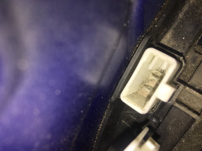

It’s the speaker wires! They’re corroded!
Taking my panels off now.
Didn’t have an issue still I moved to San Francisco right by the Pacific Ocean. I’m beating the wires are shorting. Killing the radios. My speakers had been having issues from time to time at lower volumes. 150,000 miles on a 2014 Corolla S. The speaker issue came up around 70,000 and now I’m stuck in the reboot. I doubt this will fix the radio which the short has probably killed. But will at least keep it from killing the next.

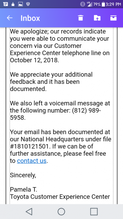

Hi There, I purchased Toyota Sport 6 mos. ago and I have this same problem, I went to dealer they said they couldn't update because it would not boot up on their system, they said hard drive is gone and it would cost me 6k to replace whole unit, which I find totally stupid. Why can't your replace or fix hard drive I don't get there meaning of hard drive gone, I don't run photoshop or word that could crash system or I don't think there was a major power surge. Only thing I can think of is that I did replace the battery about week before but still everything worked fine for that week. So I'm really not sure what's going on, but I know from research that it's happening to a lot of people and Toyota won't do anything to help unless it's under warranty, which is crazy to have a warrant for just basically a display unit. with a touch screen.
Contact Toyota and file and complaint with a case number. With enough complaints maybe they will do a recall and we can all be reimbursed. This is such a nightmare. I’m currently researching after market units.

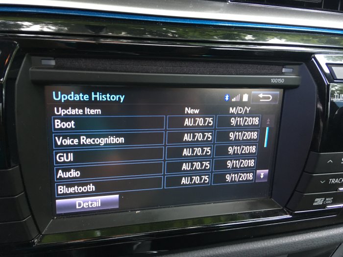

Hello,
I have a Corolla S 2014. 80K miles. Suddenly started getting the reboot issues. I read through this forum and figured I would have to replace my radio, however it looks like there is a newer software update than what was available when most of these comments were left. I did the software update and it fixed my radio rebooting issue. You can get the update here: https://www.toyota.com/audio-multimedia/#!/select-model
I will say again, A newer update DID FIX my radio. it no longer reboots.

Hello,
kirby1 do you have the exact location for the software update? mine is a 2014 corolla s with a 6.1 navigation
