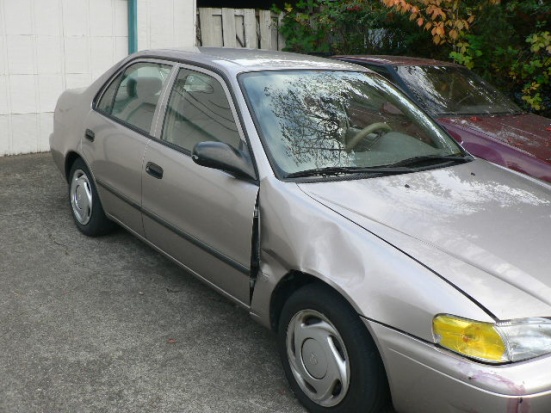

My son collided with a Harley in a intersection accident last year. Nobody hurt thankfully. Collision must have torqued the frame or something since despite being hit on the front drivers side, most of the visible damage is on the passenger side.
Hard to believe, but the car still drives great. Did a 1200 mile trek this summer in it moving my kid back from Salt Lake City. Car steers straight as an arrow without a hint of anything being out of alignment.

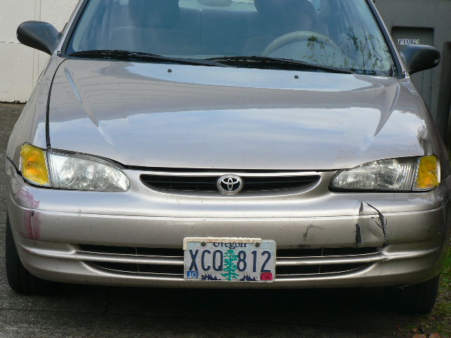

My question has to do with aligning the headlights. The impact created a two inch difference in the height of the headlights, with the driver side being higher than the passenger side.
Will it be possible to adjust them to specs? I haven't attempted anything yet.

Regarding headlight alignment, it all depends on how much body damage was done and I have no idea of that. If the impact was hard enough to knock things 2" apart, it sounds like the skills of a professional automotive body technician are needed in order to evaluate how much damage was really done.

Looks like a lot of body damage was done and several components need replacing.

My question now is.... where do I start with the body repair? Is it unusual after an impact like this to have one side 2 inches higher than the other? Is that even correctable by a "shade tree mechanic?"

As far as parts being bent and uneven from side to side, a close inspection can determine if the outer sheet metal was all that was bent, or the underlying metal, which is much more difficult to repair. Body panels can always be replaced, but metal underneath that is bent is a much more daunting job.
If the fender, hood, etc., need replacing, you can find good used body parts at the below website -
