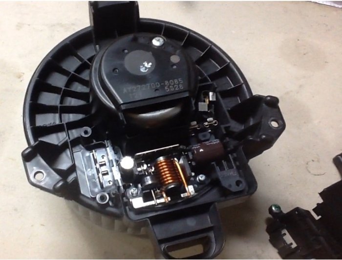

I then took the defective motor apart for curiosity sake. Sort of. There are no user serviceable parts inside. The bearing was ok and there was no shaft wobble. You can't really get to the motor without cutting. There are some electrical components which I believe control the seven blower speed settings. Nothing was loose or burnt or corroded. The power plug terminals looked shiny and new. The failure in my opinion was the graphite dust residue all over the bottom of the fins. The brushes were likely compromised. I could hear a faint grinding noise when I turned the motor by hand while the new motor was silent. See pic. It's a shame this has to go in the trash....
