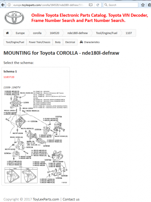

Hey everyone! I recently replaced 3 of the 4 engine mounts. I replaced the driver's side, front, and passenger's side engine mounts. To be honest they obviously needed to be replaced but I haven't noticed a big difference in how much the engine vibrates. Any ideas on what else could be causing the engine to vibrate if the engine mounts have been replaced? I mean the entire car rattles while stopped with my foot on the brake or even in park. Also I made a video for each engine mount that I replaced and wanted to share them with everyone. Cheers!
