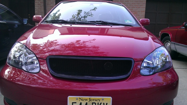

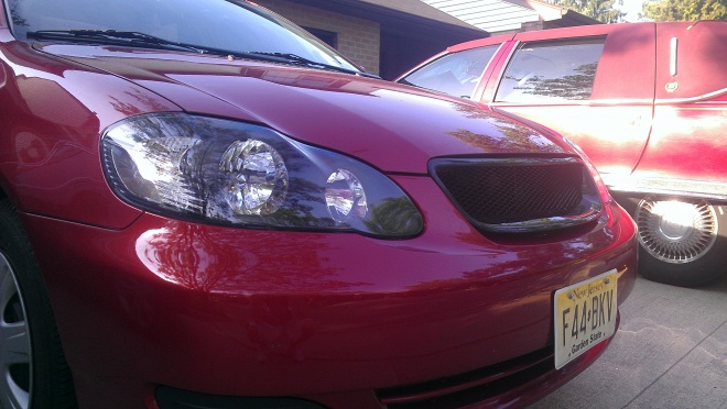

So I did the install over the weekend. You were right easy as can be. Most time consuming part was removing the bumper cover with all the clips and such. A nematic socket wrench would have helped. Lights fit perfectly and I think they look really good. I installed the Low Beam Silverstar Ultras too, definitely helps the visibility.
The grill came as a freebie with the headlights but did not fit like an OEM. Ended up pulling up in the wind while driving and cracking so I have since put the original back on, will probably paint black in the future.
