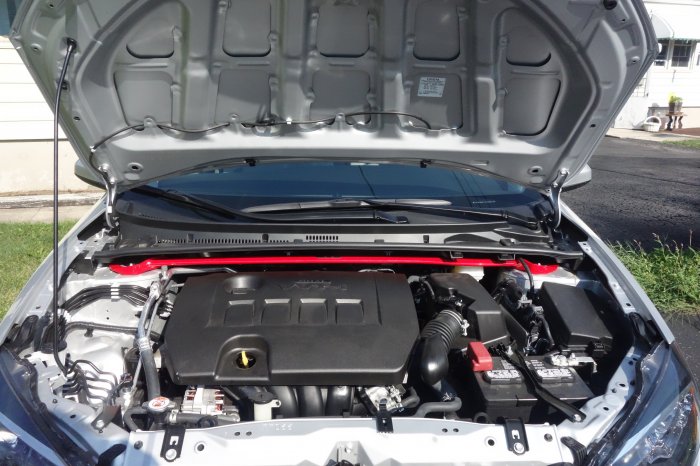

  42. george.stark
    george.stark New Member
    OK, here it is:
    The mechanic said it took an hour what with disassembling and reassembling the cowl/windshield washers etc..
    I'll probably never notice the difference, I drive pretty conservatively, usually.

    Does this protect the oil pan - or anything else down there that would cause a catastrophic issues? F'ing Chicago streets have some giant potholes - even going slow I've bottomed out. I'd rather bottom out on some < $200 bar than the oil pan.
  49. Chris Denton
    Chris Denton New Member
    A little late to respond, sorry bout that.
    The H brace would be the lowest point on your car. So if you bottom out, that’s what will be hitting the pavement.
    As it sits, your oil pan and exhaust are set higher than your front cross member, so I doubt you’ll even hit these.
    george.stark likes this.
  50. Larry531
    Larry531 New Member
    Just curious, what year corolla did you install this on
    I have 2017 LE and would like to install the front strut bar on even though it doesn't officially list 2017 year
  51. george.stark
    I had it installed on my 2018 Corolla LE. All seems well.
