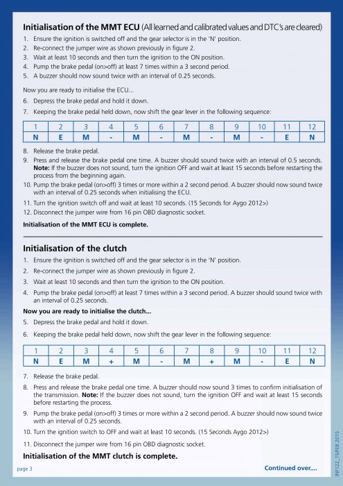

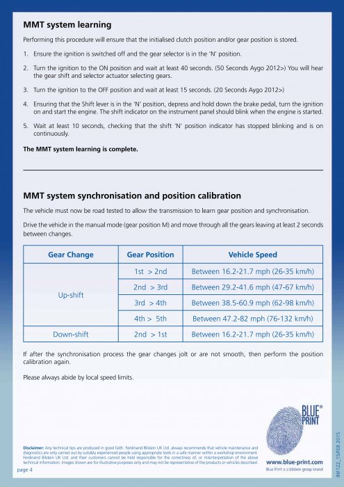

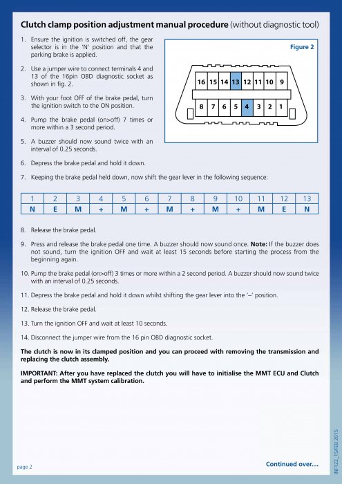

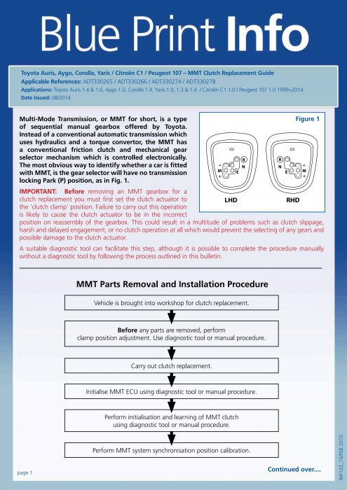

E Edmiri New Member Jul 11, 2020 #1 Jul 11, 2020 #1 Im trying based on this manual but i cant get any results. If anyone can help me i would appreciate it. 2 days trying and no success. Attachments Page 1 (quality=90).jpg 1.7 MB Views: 1 Page 2 (quality=90).jpg 1.3 MB Views: 1 Page 3 (quality=90).jpg 1.6 MB Views: 1 Page 4 (quality=90).jpg 1.5 MB Views: 1
