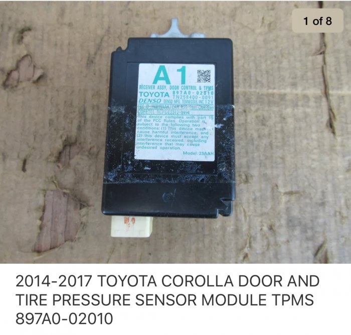

    Hello i have a 2015 corolla and the tire light came up took it to the garage and they scan all the tire all of the sensor are good the TPS module 897A0-02011 Its bad i bought it now i need to know the location so i can do it myself and save some money Can anyone advice on the location?

    Not a clue. What does it look like?

    Gotta be under the dash somewhere. I’ll look around. Thanks

    Well i found it !! The module i bought its the anthena receiver its located in the defrost wall in the back seat passenger side . Easy installation did it myself took my car to the garrage and still there is no comunication to the TPMS module he told me its another module but didnt know the location or part number ‍♂️
