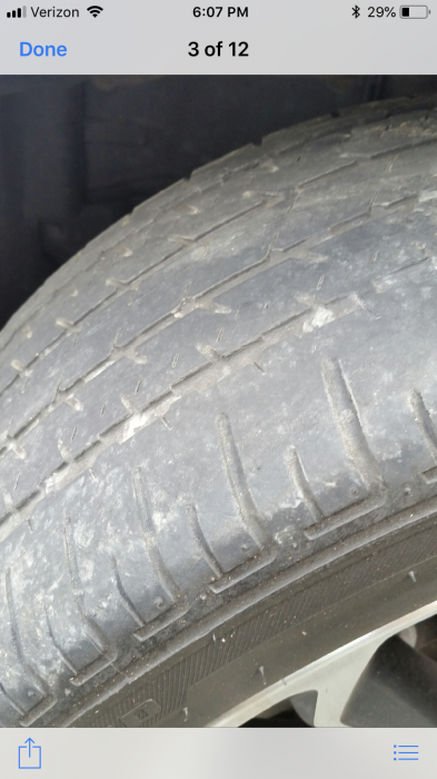

Hello!! I an interested in this 2015 s plus premium that is for sale several hours from where I live... it has 31k miles and the guy was honest with me during our conversation and told me that it was very close to needing new tires. He sent me a pic of them at my request and I was wondering is this normal tread wear for the 17 inch wheels/tires? I am curious if this car has been driven hard??? Driven easy, what kind of mileage can be expected for a new set of tires for that car? Thanks... I’m posting a pic of the tires on the car I’m talking about...
It all depends on what brand tires that the car came with. My two previous Corolla's (2005, 2010) came with Continental. Neither car made it to 40K miles before needing replacement tires. My current 2016 Corolla came with Michelin. They lasted 70K miles. I don't see any red flags from looking at the picture you provided. There is no uneven wear, and the edges are not chewed up (like someone has been using the car for autocross). I would not be concerned.
