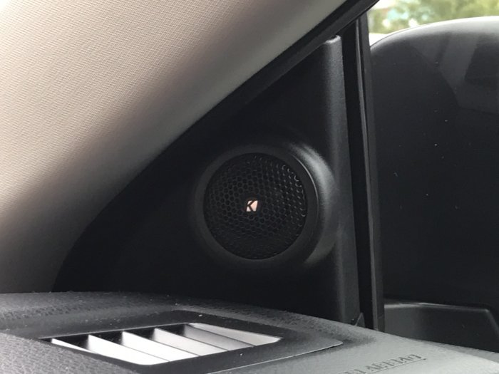

IMG_1101.JPG Sorry, but I keep remembering more info.
I used a hole saw to remove the perforations from the trim piece. Bought Kicker silk 3/4" tweeters which have a threaded nut on the back to hold them in place. I also bought a pair of replacement trim pieces in case I ever sell the car.
View attachment 2159 Sorry, but I keep remembering more info.

I have no complaints. Much better than the stock units. I don't have a lot of power running to them right now but they are crisp and clean.
The 1" model is too big and will be larger than the trim piece on the car. The 3/4" model is a perfect fit.
Kicker 41KST204 3/4" Silk Dome Tweeter - Pair (Black) https://www.amazon.com/dp/B00KC4LQFW/ref=cm_sw_r_cp_api_DcIJybCY2TPE1
I had to order an odd sized hole saw from Amazon to remove the perforations, it was about $10.
DEWALT D180025 1 9/16-Inch Hole Saw https://www.amazon.com/dp/B00005LEZ3/ref=cm_sw_r_cp_api_HaIJybEGFZ018
Then do a little trimming on the inside for a good fit.
