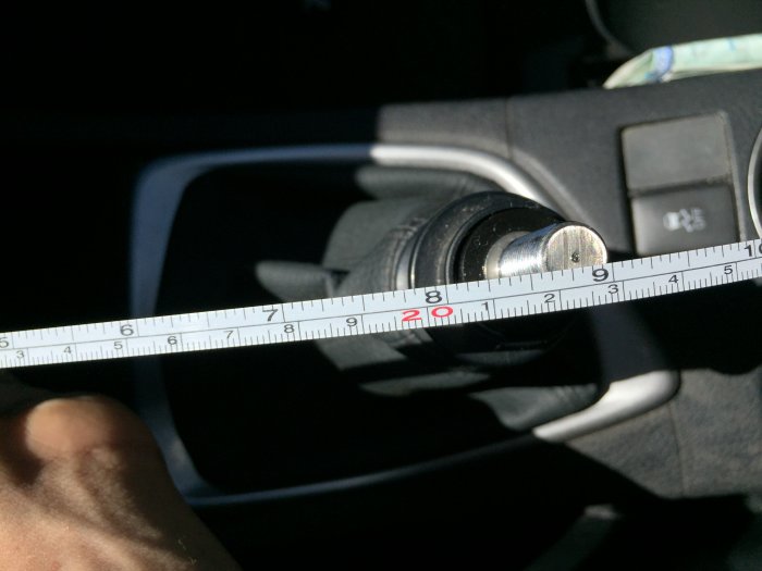

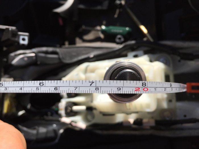

I’ll admit once everything was installed, I felt like I’d been cheated out of $267 and some change. Yeah it was stiffer and slightly shorter but not that much better! Then I took it for a test drive... way better than stock and I highly recommend getting one! Or at least upgrade the base bushings in the very least. But this upgrade is definitely worth it! Still wish it was a shorter shift than what it is but I’m very happy with the product!

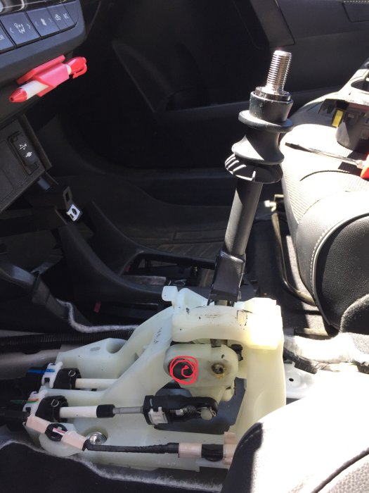

The other side of the red circle on the shifter holder pin is what will need to be cut off(if using a cutting wheel, make sure you’ve got something to catch sparks). This kit comes with directions, which makes installation much easier. I highly recommend it and you won’t understand how great of an upgrade it is till you have one installed and drive around with it.
