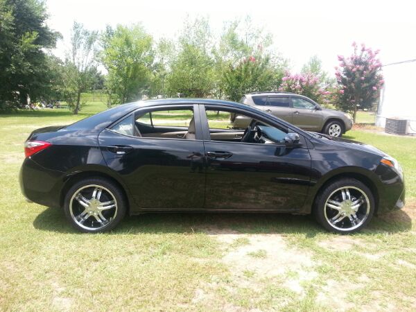

Nice, if you add some 10th gen Eibach lowering springs it will look on point!
Thanks I'm planning on doing that in the future also thinking about either adding LED fog lights or an S model bumper or both when the parts become available in in salvage yards they want almost $804 for everything to fit the S model bumper.
