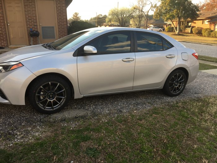

The 17's will sit pretty much where your stock wheels are now.
The 18's will bring them out, flush with the body.
Based on your listed offsets.
Stock wheels are 15x6 33mm offset or 16x6.5 39mm offset or 17x7 39mm offset.

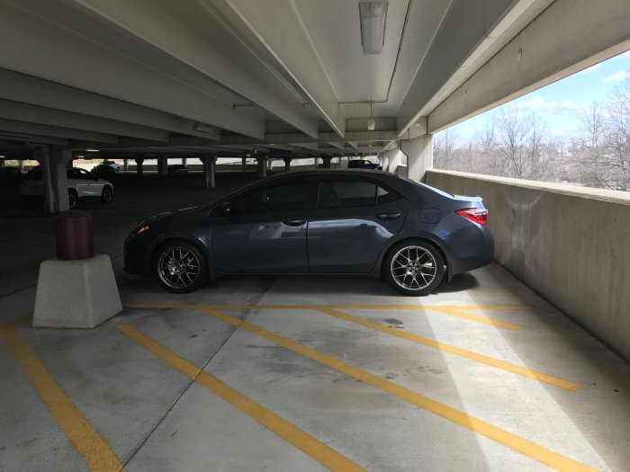

I'm on 18x8's 35mm offset. This combination will bring the wheels flush with the body. I'm also on TRD lowering springs, so this pic should give you an idea of what your car could look like.

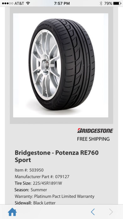

As for tires? Was going go with 225 40 18 from discount tire. They have these was wondering has anyone used them?
Road Hugger GT Ultra
