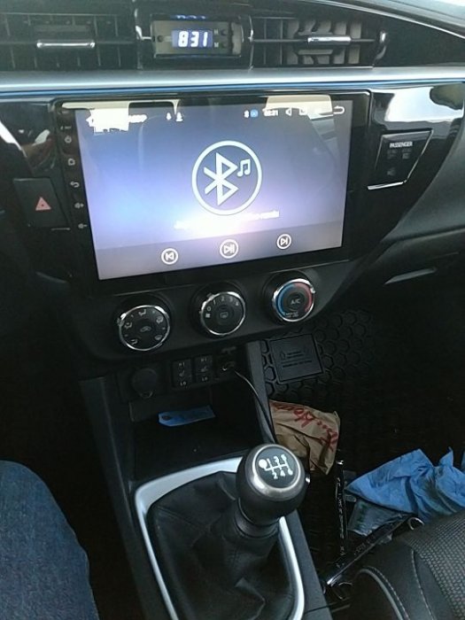

Switched out everything on my 14 rolls, I first switched out my mids and 6x9s with Kenwood and added 6 Rockford fosgate t1ts tweeters (stock power) very clean crisp sound for stock power, I just got done last weekend pulling out the stock double din and replaced it with a pioneer double din (pioneer avh-x4800bs) ordered it from crutchfield.com including wiring kit and dash kit, sound is amazing now just need the alpine power pack (in dash amp) and my speakers will be screaming, running on stock power I can hear my highs from 300 feet+
When u order from crutchfield and get everything with wire harness I was able to use my stock back up camera, steering wheel controls, stock aux input and stock usb input, the only thing I was unable to use was my stock microphone with Bluetooth hands free so I had to run the pioneer Mic into the spot I wanted, all in all easy install but it took me 5.5 hours

I didn't ever use any of that so I didn't need to have it converted for pioneer, changing out my stereo didn't affect anything with the car, I still have my average mpg on my dashboard, car is always in sport mode since it is stick shift and I never was able to use eco mode since there was never any buttons for it

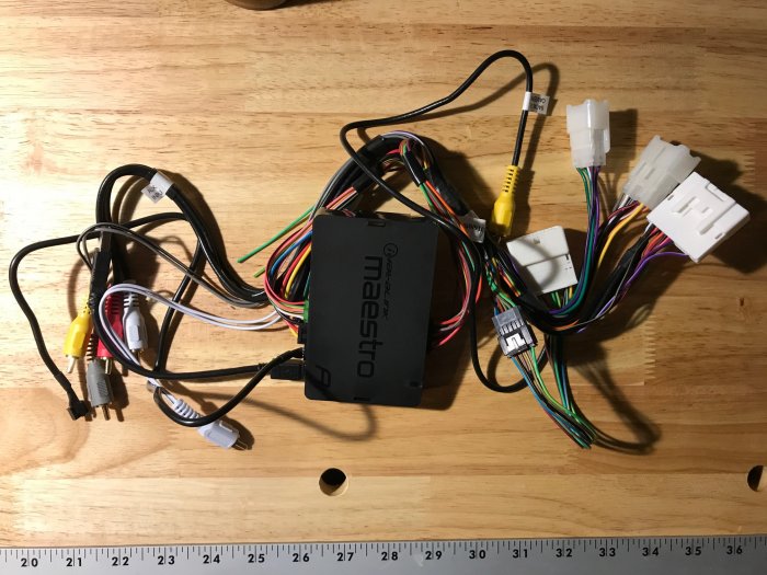

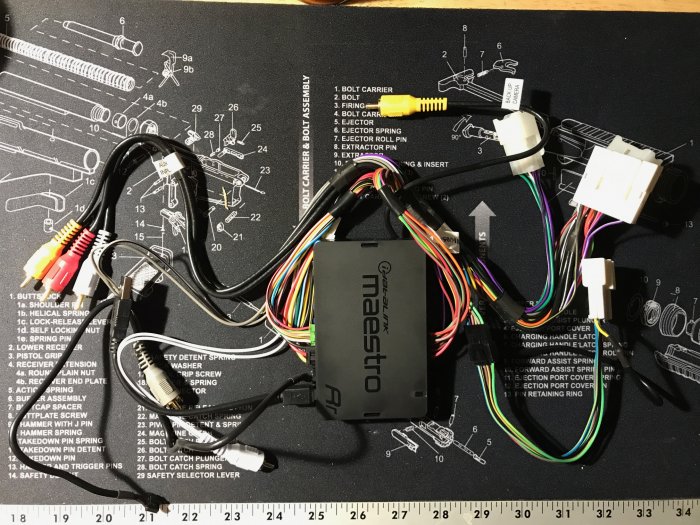

I've already bought the datalink wiring harness, should be here tomorrow. Crutchfield was too high on the maestro though, even if I bought it with a head unit. I'll pick that up from Amazon.
I'll take some better pics of the harness and post it here tomorrow.
