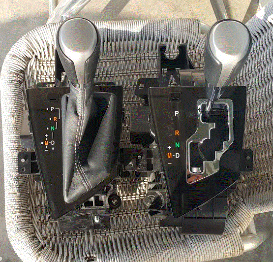

The shift plate that has just the slots and no boot, is on European models only. Best I can determine. Right hand drive.
I might get a universal LEATHER boot and make it work. I’m also looking into the TRD Pro shifter for the Tacoma. It has a square base for the factory boot to reattach to.

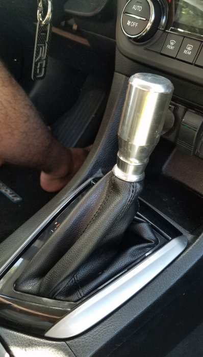

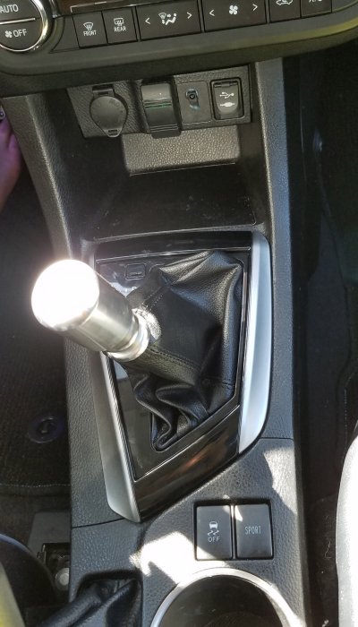

Yep that was my problem exactly. What a pain in the rear to put in a universal boot because of the weird shape that ours has. I finally got it though and it looks and functions perfectly! I'll upload pics in a little bit

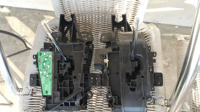

You can actually remove the ring that came from the original shifter boot and replace with a generic ring. If you remove the top plate with the prndm from the shifter assy you can see from the bottom that this ring is only held by plastic tie wrap.
That TRD shifter though is made for gated AT w/o shift boot so the ring is an inverted cone.
I replaced my PHDM gated shifter with the USDM shift boot type and somewhat misses the original leather shift knob.

I'll just leave these here. The right one is has leather shift knob but the lower chrome part is not interchangeable because they have different key slots. Shifter.GIF 20160611_164202.jpg
