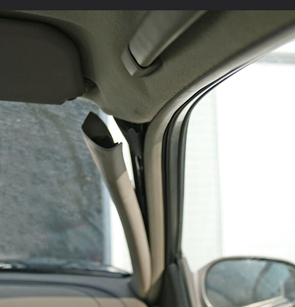

c. the plastic trim piece [passenger side] between the side of the windshield and the door window is loose and hanging from the top end. I do not see clips. How to get it to stay where it belongs. Photo attached

the plastic trim has a clip, that looks like it is attached to the frame of the car. take a tool, remove it and place on the plastic, snap back into place. If not get some Velcro, or double sided tape and press on.

c. Refer to what fishycomics said.
