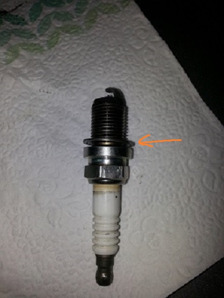

As most you know I have been relentlessly trying to troubleshoot a P0303 (cylinder #3 misfire). Today I removed the spark plug from cylinder #3 and noticed the mental ring was stuck to the thread and wasn't flush with spark plug like the others (see image below). I was able to loosen the mental ring from the thread and it now sits properly. Could this have possibly contributed to the misfire on that cylinder?

Yes, it's possible that could have caused a problem, as it could cause a leak and lack of compression, leading to a misfire.
Did you compare the appearance of the #3 spark plug with any of the others? That will provide a lot of clues as to what is going on. Posting pictures of the end of the spark plugs where the spark occurs will help so I can see what they look like. Use a bright light to illuminate them.

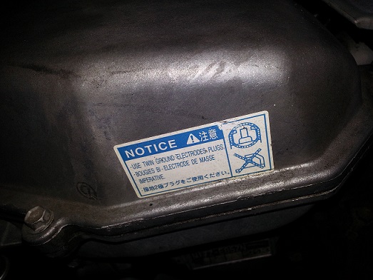

Check this out. I found a sticker on the side of my engine that reads. "Use Twin Ground Electrodes Plugs" There is even a illustration that has a big X over the picture of a traditional plug. Interesting...did you guys know about this? I am glad I swapped the spark plugs with the one they recommend.

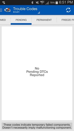

Hey Scott to answer your question. I just checked pending codes using my obd2 scan tool app. No pending codes are stored. I will give it a couple of days before I admit defeat to the elusive P0303.

My ex's 4Runner and her Daughter's Tacoma (both with the same 3.4L V6) specified the use of dual-electrode plugs as well. I never tried running a standard plug in either of those engines. I'm pretty sure that the 1.8L engine in my Corolla uses standard plugs so maybe the dual-electrode plug was something Toyota only spec'd for a couple of model years.

Is the engine running better with the new spark plugs? Is the #3 cylinder still misfiring when cold?
Scott,
The car is running great! It now has been two days and no misfires! I again checked today with my scan tool app and guess what? No DTC pending! I don't believe it. Could it have been the spark plugs all along? It sure seems that way, ever since I installed the factory recommend dual ground electrode spark plugs I have not had a misfire. I will keep and eye on it for few more days and then talk to my mechanic about the plugs. I hope we have finally nailed the problem only time will tell.
