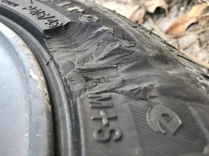

Found it at 21,2XX. Discovered when rotating tires. Inside sidewall. You can even see where the chunk edge is rounded from hitting the road.
hohooooly shit. Looks like a car goblin took a nice bite out of your tire. Probably as an afternoon snack.
All seriousness though, you should get that replaced ASAP. You don't wanna blow out going 60.
