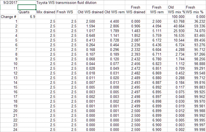

So my question really centers around how many D&F operations I need to do to get to ~90% fresh fluid (fresh being rather subjective). I've been doing D&Fs every other oil change (got the car with 93k miles) and based on a total capacity of 6.9 US quarts (reference from an Amsoil source), I find I'll need about 5 changes to get to about 90% 'fresh' fluid.
Here's a spreadsheet I did to show the fluid dilution over time based on my 2.5 quart drain and fill. Of course fresh is a relative term given that OCIs are 5000 miles so a D&F happens every 10,000 miles. Perhaps I need to bump that up to every OCI until I get about 90% 'fresh' fluid. ;)
