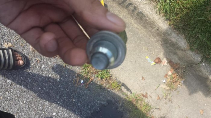

Dam it Fishy! you jinx it! omfg. I was able to loosen the three tires, but the driver rear wheel nut, well.smh. It broke! wtf. wtf ahh! And I done this before. never had this problem.
I had the tire rotation done at the dealer like few months back. They F**ked it up!ahh

yep we all talked about jack stands not lug nuts being crossed threaded. Easily replacable, do not worry bout a $5.00 stud?
Sorry to hear. one step at a time!
#48
lol easy to replace But the three wheels I loosen, all the nuts were extremely stuck. and all the nuts on the last wheel was so stuck I couldn't get it removed. Instead broke one. So I am not touching them. Going to take it to the dealer that rotated my wheels few months back. They better replace all of them. This was a sunny day and could be the last for dipping. ****in A! smh
Btw, is it safe to drive with one broke stud?
