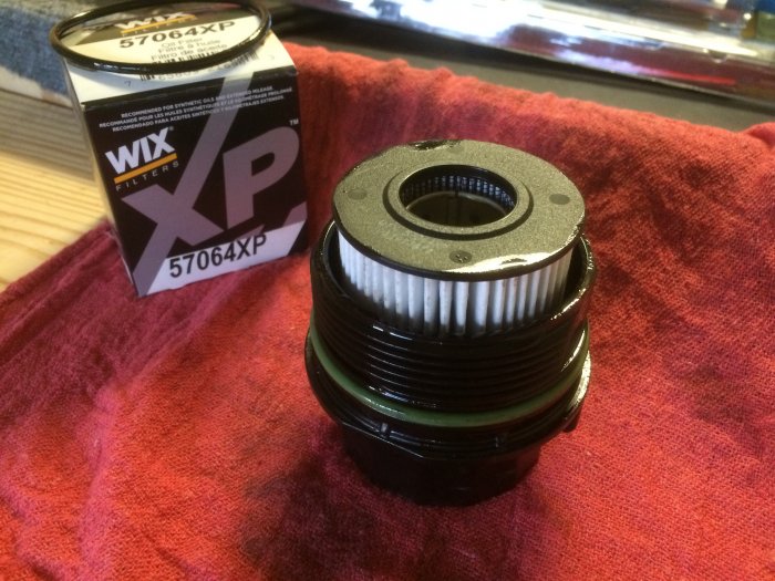

Using Mobil 1 0W-20 Advanced Fuel Economy and WIX 57064XP filter.

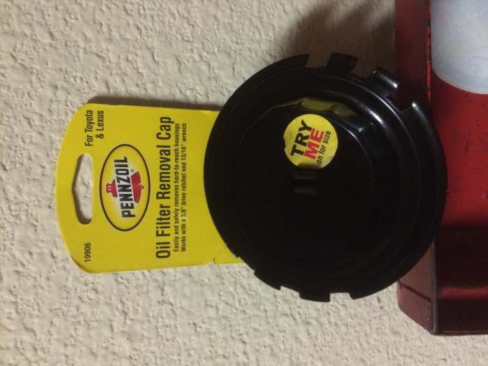

This is the first car I've owned that needed a special oil filter wrench. Had to go buy one. Found this at O'Reilly's. Pennzoil 19906

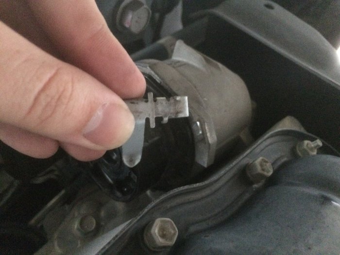

Remove clip that prevents oil filter housing from spinning off.

Swap out oil filter and o-ring on the oil filter housing.
Wipe excess oil from engine at oil filter housing. Reinstall filter housing with new filter and o-ring. I tightened mine to the same spot it was at and re-installed the clip. Take a picture before removal for reference.

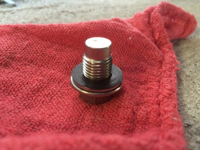

Make sure to change the gasket on the oil drain plug. I used a Dorman part. Aluminum with rubber for sealing. OEM appeared to be aluminum with fiber.
Replace oil drain plug.

Filter I like more paper then to have a washer covering the end. otherwise great job. I simply bend the safety clip and changed, you took yours off???
If you're talking about the difference between the stock filter and WIX filter yeah I was kind of shocked at the difference. I figure it's fine though.
The filter wrench fit better with the clip removed. Over time bending and re-shaping might break the clip. Looked like the right thing to do.

I have done 12 changes about and No issues on that clip, Slips right under like a glove, if car is cold its tighter the filter. and its much more fun to get off Lol, or I am getting older and wiser Lol.
