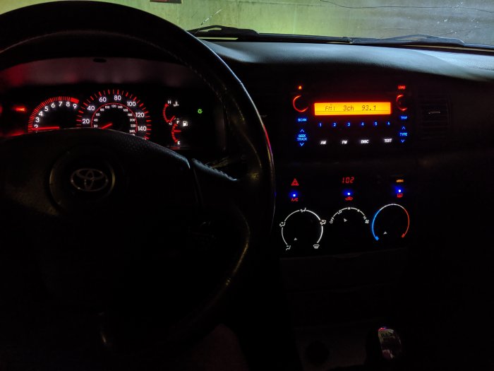

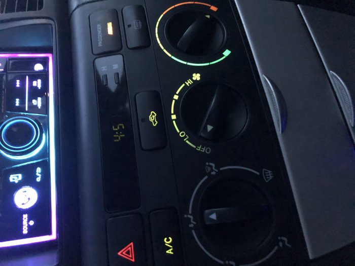

Could be faulty wires. If you have a bad windshield and water is getting in then it can short out wires. Test the bulbs, if that’s not the issue then move onto the wires. Check for corrosion, anything not normal colored is faulty. I’m pretty sure a fuse wouldn’t have gone out because then none of the lights would work. I’d check wires and windshield.
